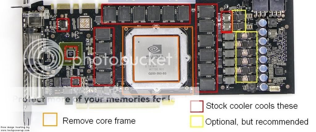

Perhaps you could show us pictures when you are done installing it - you could even take pictures of the process? It is always nice to see things done rather than reading about it. Just make sure if you go out and buy additional heatsinks or mosfets, because you wanna use better ones than comes with the cooler, that they will fit and you do not need to cut things. I used some pure copper mosfets to cool the VRM regulators, but I had to cut like 2-3 mm for clearance. The VRM regulators was not covered when buying the GTX 280 and it did not cover everything - do NOT buy that - buy the GTX PRO.

Well I did it myself with my Accelero Twinturbo on my 8800GTS and again with the Accelero Xtreme GTX 280 onto my GTX 285 - with some modifications. This picture shows my GTX 285 when the stock cooler is off. You see all the crap they put onto it? I removed everything and cleaned it - you really wanna read the manual if you do it yourself. I suggest using some hard eraser to clean the RAM´s and voltage regulators and then you remove all the old paste on the GPU and you clean it using some ArcticClean. This picture shows what needs to be covered. I am unsure how much is covered using the heatsinks you get, but knowing that the GTX PRO is an updated version I am sure they covered everything. The ones highlighted in yellow are the voltage regulators (VRM) - there are six of those if it is like mine and I used pure copper mosfets to keep them cool, but you can use the heatsink that comes with the aftermarket cooler. Then there is the ones highlighted in red - those are the RAM and you just use the heatsinks like it says in the manual. These mosfets were the ones I installed on the VRM regulators - pure copper and rather expensive. I had to cut them off 2-3 mm, but you just measure if they are to long touching against the heatsink fins. But just follow the instructions in the manual and be sure to remove the bracket on the GPU if it says so in the manual or if it is not needed there. You want to make sure the aftermarket cooler has proper contact with the GPU plate. Do not play for hours when first installed, but read the temperatures after first race using that logfile, to make sure that it has proper contact. It can be a freighting experience at first, but the satisfaction of doing it yourself is great. Get a friend to help you perhaps. Poul

i've just finished installing the GTX cooler, massive massive temperature drop!!!! going from 58-60*c at idle to a measly 42*c at 50% fan speed ( 1,400RPM) is excellent!, i'll wait for a day or two for the thermal paste and everything else to settle down a bit before i try it in any games. but going by the idle temp drop i dont think i'll have any more overheating issues
